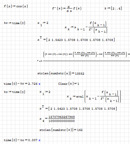

Hi. This example can illustrate what Davide says.
using_eval.sm (19.85 KiB) downloaded 1552 time(s).
