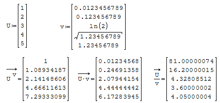

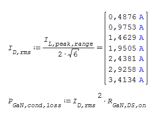

Is there a more convenient way of segment by segment multiplication of ranges than using a for cycle.
I am trying to solve the following:
(the problem is that all the data in the range should be segment by segment squared)
and also
Currently I have been able to solve the examples using a 'for' cycle:
But my question is: Is there a more convenient way to multiply, divide, square and root ranges segment by segment?
Thanks in advance!

Use vectorize from Matrix palette.

Thank you Radovan!
It saves a lot of time!
