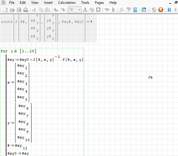

6179 does not crash. It ends @ Syntax is incorrect.
It does not understand "roots" and the otherwise Jacob.
... from an input vector, you apply some maths
ending to a resulting vector. What are you
attempting to solve between these two vectors ?
Primer38b [Unknown].sm (50.24 KiB) downloaded 1049 time(s).

We already had a discussion about this problem many times, see this thread for example. To repeat once more. It tries to solve the system of nonlinear equations f(X)=0 (eleven equations with eleven unknowns). This is a version of the well known "flash calculation". I posted it a long time ago and also mentioned many times that this problem remained unsolvable for me in SMath. I mentioned it this time pointing out the interruption of never-ending calculation.
Regrettably, these problems of solving nonlinear equations remained unsolvable for me in SMath for many years and I am trying to give up on them. Nevertheless, regarding this problem I was triggered on once more by this post.
