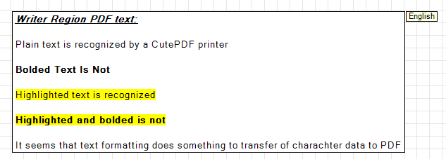

Wanted to bring to your attention the following peculiarity of printing .sm file with a writer region to PDF. Not all text is recognized as text in the resulting PDF file (makes the PDF file non-searchable). There is a patter to the madness, so there is hope that something can be done.
Many thanks for the region! I use it all the time.
WriterRegionPrintToPDF.sm (2.18 KiB) downloaded 1603 time(s).
WriterRegionPrintToPDF.pdf (20.83 KiB) downloaded 800 time(s).

I'm aware of that; there's not transfer of characters or text between plugins and the pdf printer, the worksheet is processed as an image and the OCR of the printer you use it may produce a better or worst result. Part of the problem however is in the plugin itself because the text is not rendered at "full quality" (because issues in GDI+ vs text measurements); this is something very complex to address, recently I've seen a possible solution/improvement that involves the use of unmanaged code from the OS (namely the technique used by this project:HTML renderer), but I don't know if this may break the plug-in compatibility in some OS (and how much work would be needed to replace the part of code involved).
From the sounds of it, the benefit would not justify the difficulty of the tweak.
