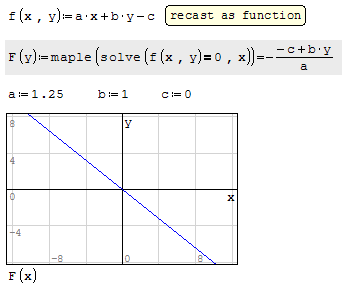

#4 Posted: 2/12/2022 11:55:56 AM
... get lot more from maple companion.
ODE Symbolic Verhulst [Logistic].sm (25.55 KiB) downloaded 972 time(s).
