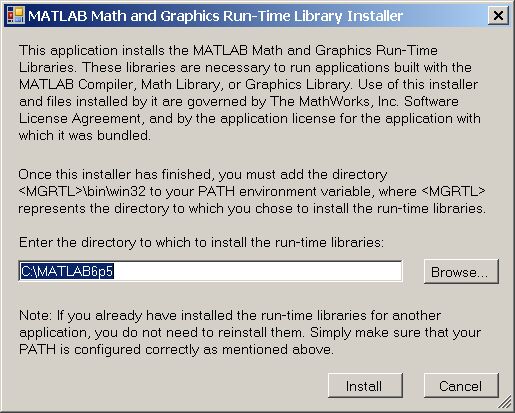

CorFlags will help you to use this plugin on 64-bit system. mw prefix means: Matlab Workspace or MathWorks.

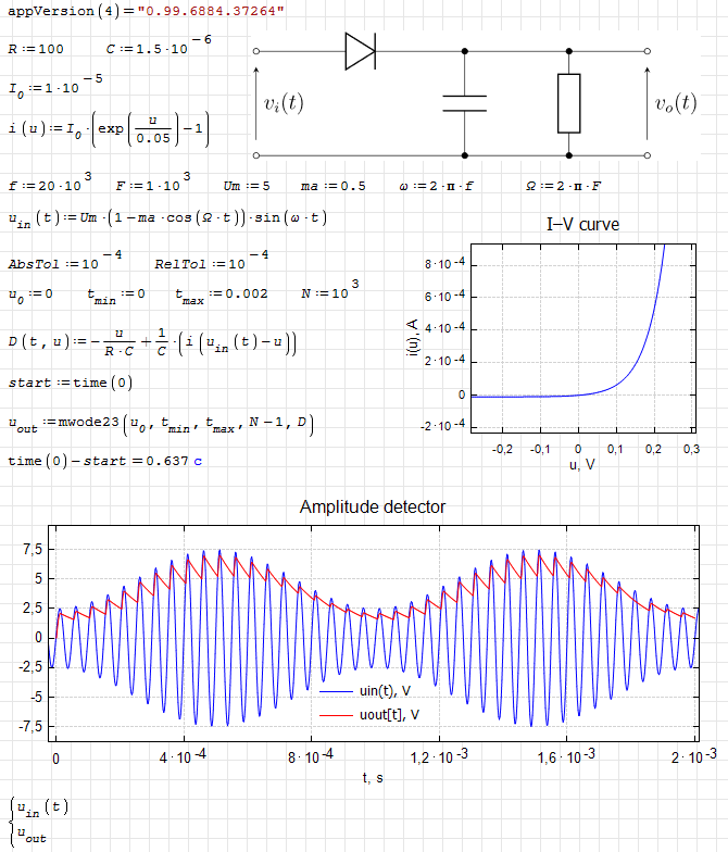

Matlab C++ Math Library. ODE solvers. Amplitude detector.sm (14.36 KiB) downloaded 2382 time(s).

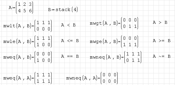

Updated. mwsign(1), mweq(2), mwge(2), mwgt(2), mwle(2), mwlt(2), mwneq(2) added.
Relational operations (Reference, p. 32).
Davide Carpi 8/20/2013 7:30:00 AM, Radovan Omorjan 8/20/2013 7:23:00 AM

Thank you uni. It seems I was right
By the way, the second argument does not need to be a matrix. Scalar will do the job as well

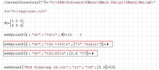

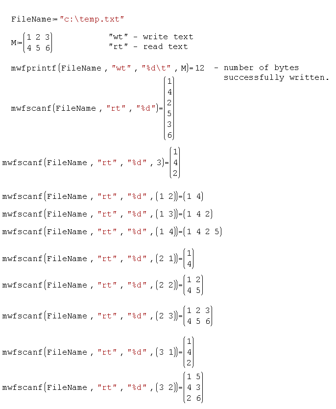

Updated. mwfprintf(4), mwfscanf(3), mwfscanf(4).
Quote
Yes, but it's an undocumented feature. The function takes a matrix as a parameter.
Martin Kraska 8/21/2013 5:46:00 PM, Radovan Omorjan 8/21/2013 5:40:00 AM

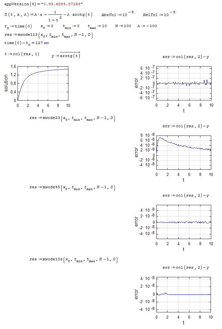

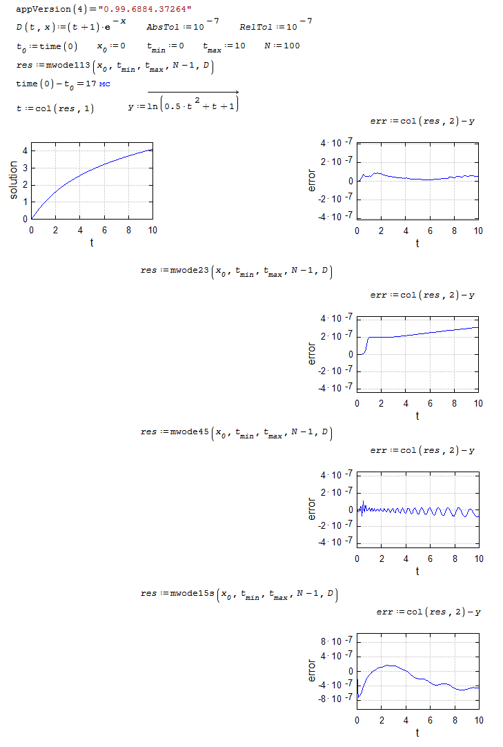

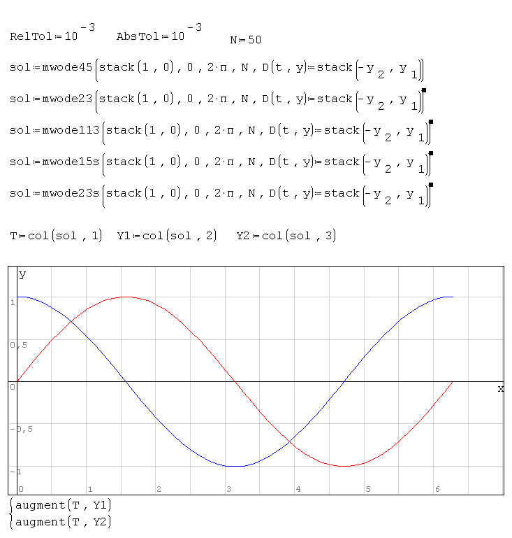

Updated. mwode45(5), mwode23(5), mwode113(5), mwode15s(5), mwode23s(5) added.
mwode45(5) - (init, x1, x2, intvls, D) solve non-stiff differential equations, medium order method.
mwode23(5) - (init, x1, x2, intvls, D) solve non-stiff differential equations, low order method.
mwode113(5) - (init, x1, x2, intvls, D) solve non-stiff differential equations, variable order method.
mwode15s(5) - (init, x1, x2, intvls, D) solve stiff differential equations and DAEs, variable order method.
mwode23s(5) - (init, x1, x2, intvls, D) solve stiff differential equations, low order method.
Matlab C++ Math Library. ODE solvers. Arenstorf orbit.pdf (99.13 KiB) downloaded 1272 time(s).
Martin Kraska 8/21/2013 5:45:00 PM, Radovan Omorjan 8/21/2013 8:11:00 AM
Quote
Now it is documented, but perhaps not officially supported ;-) Is there any chance to overload the operators? Do they have internal functions that could be overwritten?
Also, thanks for the file ops. Writing of strings is not supported so far?
I fail to read the datafile even if I remove the first line with the column titles. Would be interesting to see what performance we get.
