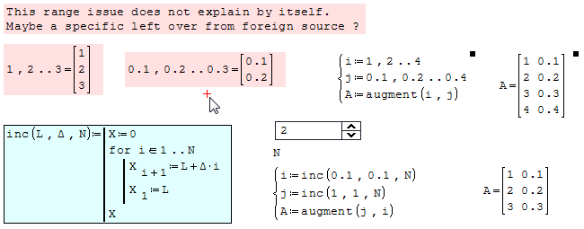

Hi. Is that ok?
range_issue.sm (2.74 KiB) downloaded 800 time(s).

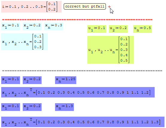

Is that ok ?[/quote
... doctored otherwise from undefined 'zero' in Smath.
rangeissueDoctored.PNG]

Second argument isn't guaranteed in results, as reported in the function description. The reason (as shown by Jean) is that the calculated increment value and/or the results might introduce a small error. We might see if can be somehow improved, though.
frapuano 11/13/2018 6:34:00 AM
#5 Posted: 11/13/2018 1:57:27 AM
Thanks Davide ... Reconciliation as demonstrated.
