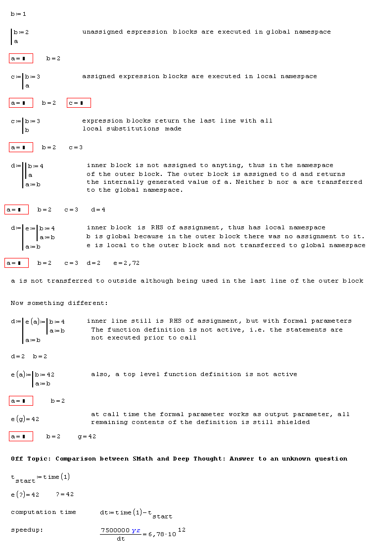

Here are some tests with the last line of blocks being assignments. Seems that in local namespaces these assignments are ignored and the block just returns the RHS of that assignment. Thus the assignment target is not transferred to outer namespace even if it explicitely appears in the last line of the block.
Also, for me it looks like that function definitions are inactive as long as the function is not called.
I might not have been complete in my explanation of the last line of the line function's behavior and therefore must clarify its behavior to remove any unresolved confusion. The last line funnels an expression, not to the general global environment, but to the LHS of an assignment operator in which the line function is the RHS. In your examples 4 and 5 you express a := b. The value of local variable b (not local b itself, nor the value of global variable b, nor global b itself) transfers to the global d. This is correct behavior as intended by the design of the line function in smath. The assignment to a in the last line is treated the same as in any other line in the line function and is therefore a simple assignment to local a, not global a. This again is correct, intended, and consistent behavior.
As you pointed out previously, a free floating line function does not have local variables, so the above behavior does not apply.
In all your examples 1-5, the behavior of the line function is correctly predicted by the rules we have learned from our prior experiences and our recent observations of its free floating use cases.
In examples 6 and 7, the functions d and e(a) are fully and completely defined by a line function on the RHS. If there is activity inside the line functions, it is all executed on local variables and cannot be ascertained by interrogation in the global environment. If we had the ability to use -> or = within the line function environment and have the calculated values show up from within the line function, we could tell. In the end, it doesn't really matter if they are active locally or not. What matters is the global effect. The effect on the global environment is what we must be able to detect and understand. Coming from within a line function that completely makes up the RHS of a function definition, the behaviors of examples 6 and 7 in terms of the effect on the global environment are exactly what we expect.
Function definitions in general do not necessarily contain line functions. Without that shroud, the operations taking place within the function definition are active in the global environment, are subject to the context of activity and variable substitutions prior to the definition, and effect activity and substitutions coming subsequent to the definition. Functions may be complex and contain parts that are globally active and other parts hidden by line functions. But the rules apply consistently to the individual pieces and make a predictable whole. I failed to mention this in my previous explanation.
As for your example 8. Finally, somebody has seen the face of god and brought the answer to the nature of the universe back to us mere mortals. With the mystery now unveiled, the stars will burn out one by one, eventually leaving a dark and physically lifeless, but fully spiritual universal existence in its wake.

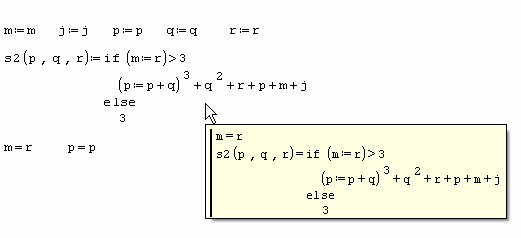

Now consider a more advanced function:
m->m, j->j, p->p, q->q, r->r
s2(p,q,r) := †if (m:=†r)>3, (p:=†q+p)^3+q^2+r+p+m+j, else 3

#16 Posted: 12/16/2012 11:45:59 AM
Hello Rising Eagle, mkraska
m->r, p->q+p
dynamic assist shows the function defined as s2(p,q,r)->if (r>3), 2*r+p+j+(p+q)^3+q^2, else 3
Thank you again for these posts and your patience to follow all these issues. Martin (mkraska) and others pointed out our frustration by not understanding how all these things actually work.
Rising Eagle - I hope you would not mind if I suggest you to use MATH tags to represent the SMath regions and/or to use attached pictures - screenshots (see the attached picture, please). It would be much easier to follow your discussion. As you could see, it seems that I did not manage to reproduce your above example presented in simple text. It might be due to your (or mine) mistake or due to the SMath version difference - I used the recent one.
I also agree with Martin that excluding the visibility of "->" operator (symbolic equal to) in recent SMath versions in fact causes more confusion, in spite of its visual effect to represent it as ordinary equal to "=".

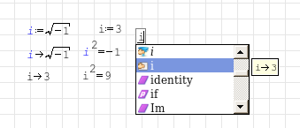

#18 Posted: 12/17/2012 9:14:46 AM
kilele
kilele
134 likes in 397 posts.
imaginary i is reserved and smath confuses itself as explained below
suggestion: use the unicode i with macron
ī:=sqrt(-1)
After this assignment Smath suggests ī whenever the user presses i

#20 Posted: 12/23/2012 7:17:00 AM
Rising Eagle
Rising Eagle
15 likes in 23 posts.
ī:=sqrt(-1)
This is good information. Once the preassigned value of a default symbol is assigned on the smath sheet to another symbol, the default symbol can be reassigned in any other way and used as desired. Definitely good to know.
I have an alternative to your suggested reassignment: i is the imaginary unit. As a unit, it should be treated as such and assigned to a blue character. Just type:
'i := i
PS - I would like to use italics. I could use a cut and paste from a character map, but I would rather use a ctl-key that works in the same way the ctl-g key transforms a roman letter to a greek letter. If anyone knows how, please reply. It's interesting, the blue i shows up in DA as an italic, but as a regular roman character on the smath sheet.
