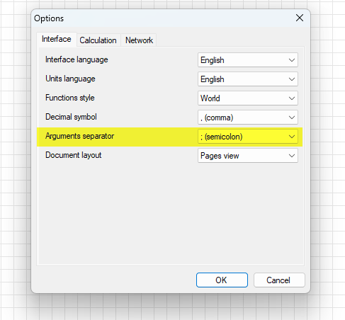

#2 Posted: 3/20/2025 10:16:41 PM
To add conditions, inside one of the if placeholders (the black squares) type the argument separator (usually is the semicolon ; or the comma , ).
Press it multiple times to add multiple if/else conditions. Use the backspace to remove cases.
