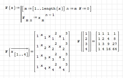

is there an inline-variant of the loop mentioned in the picture,
loop
because when i try to add an index to the function w(x) it throws a syntax error.

Hi Crang. This could be an option
VandermondeMatrix.sm (6.99 KiB) downloaded 1060 time(s).

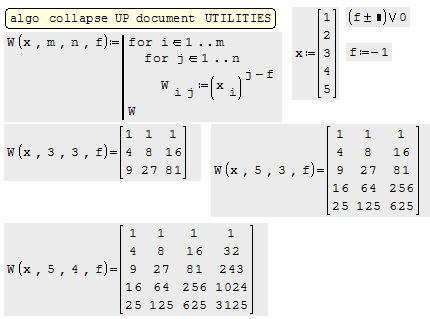

Make it algo style for infinite local use.
Cheers ... Jean.

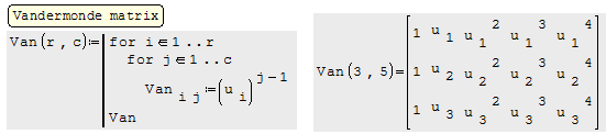

#4 Posted: 5/25/2022 7:38:47 PM
... make Vandermonde algo style for any local symbolic/numeric
