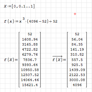

Hi, Is there a reason why I'm getting those obviously wrong results?
#2 Posted: 9/28/2023 12:35:00 PM
Alvaro Diaz Falconi
Alvaro Diaz Falconi
1,076 likes in 1,749 posts.
Hi. Looks like a bug in the "implicit scalar expansion" according to the expression in matlab for vectorization. Use explicit SMath's vectorize as workaround.

Thank you very much. At least there is a work around!

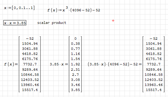

Hi. Looks like a bug ...
Or not. It depends on how x^3 is interpreted. If the usual recursive definition is used, x^3 = (x^2)*x, then x^2 = x*x would be a dot product, while x^3 = (x*x) *x would be the product of a scalar times a vector, and the SMath result would be correct, although perhaps not the 'expected' one.

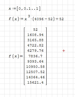

Greetings,
Just as a note of 'Good Programming'; don't use the same variable when defining your declaring your function as you are passing into said variable for evaluation.
For example:
  • instead of f(x):=x³ and x:=[0,1..3] and f(x)=▮;
  • declare f(_z):=_z³ and x:=[0,1..3] and f(x)=▮;
This way you can keep local and global variables separate and avoid confusion. I've had instances where local variables became global, and I accidently used a global variable locally. Else, you end up asking yourself "which x is being using? x as in the variable or x as in the parameter of the function?"
May this be of Good Help;
⚜ Kenny Lemens, P.E. ᵂᴵ
