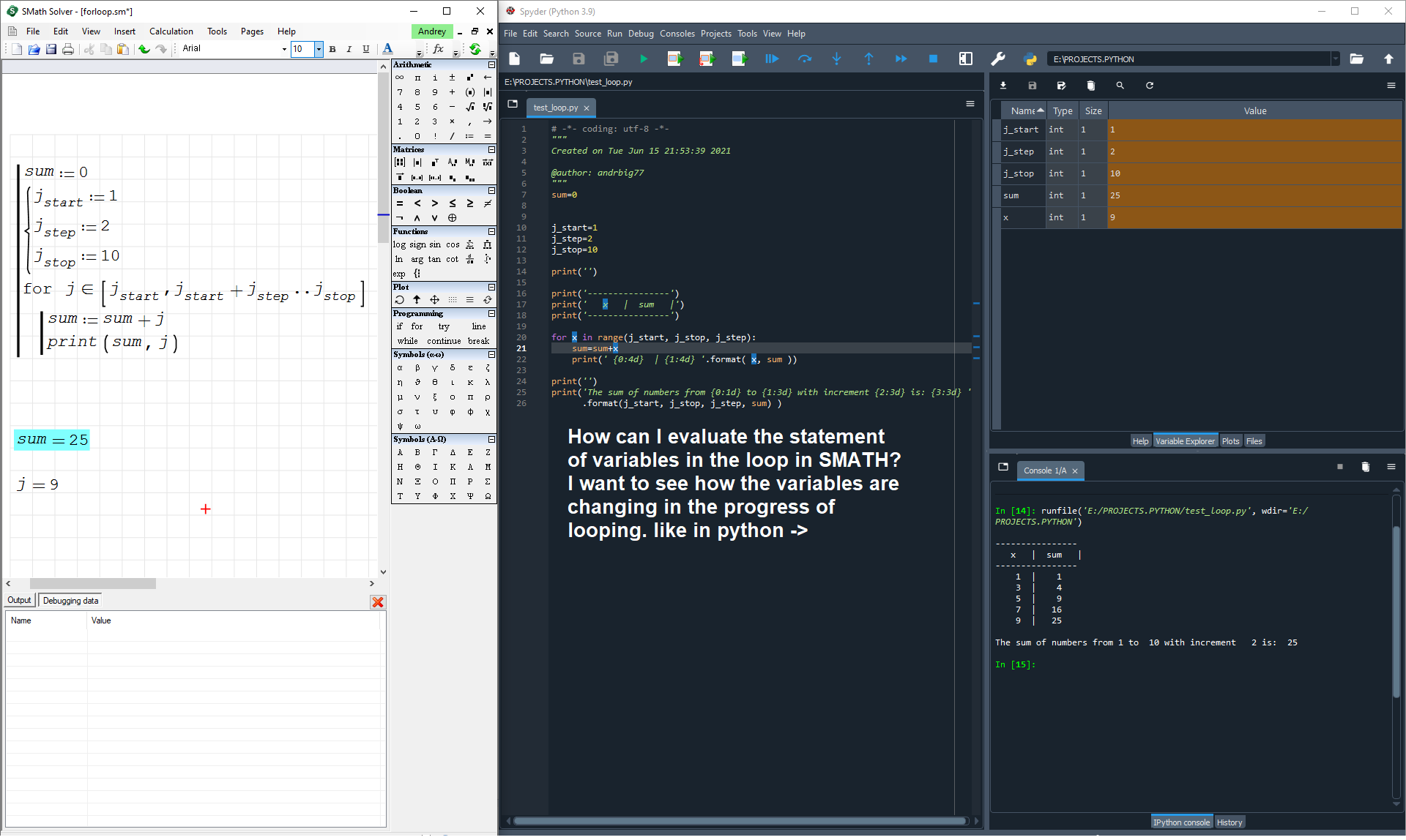

Dear Smath-experts,
How can I evaluate the variables in the loop in SMATH?
I want to see how the variables are changing in the loop like in python.
Is what debug is for, but how does it work?

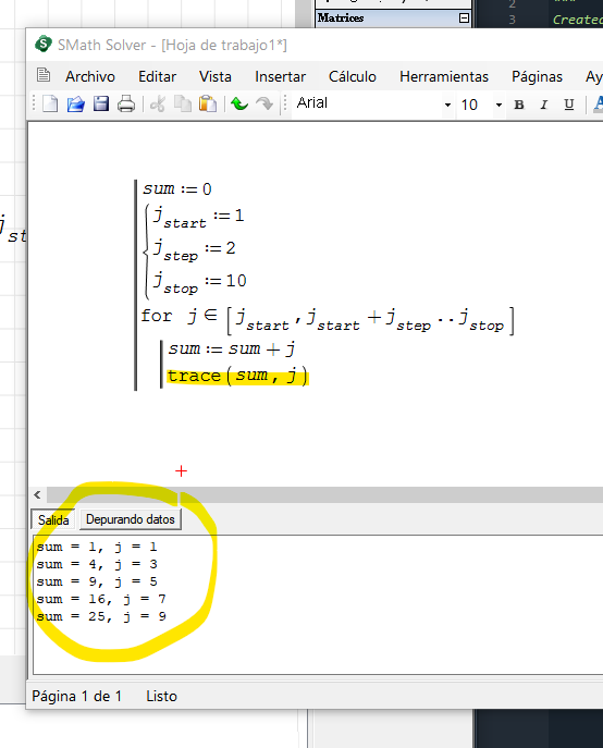

Hi Andrey, you can use trace() for check how variables are changing in the loop:
Oscar

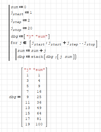

trace() or breakpoints are usually de-facto way to go.
Alternatively you can store variables to a matrix.
