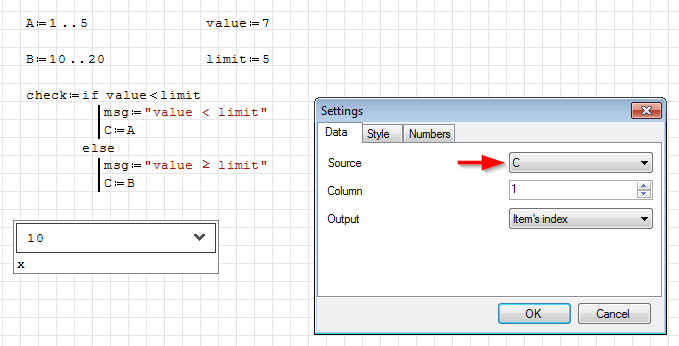

2. Can I have a combobox as part of an if_then function? If one condition is met, use one combobox, otherwise use a second.
Yes you can have it
