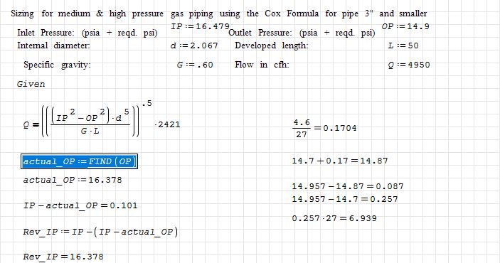

I have landed myself into a new IT/troubleshooting position at a new company and one of my first tasks is to resolve a many year long issue.
We have a very old laptop that contains two formulas for calculating Low pressure and High Pressure drops in Gas piping for construction work.
we have been using a very old version of mathcad and while surfing the web I came across Smath and i believe i should be able to perform the same executions with this software.
I tried to open the existing files into Smath but the equation no longer solves.
I believe my issue is finding the corresponding function from Mathcad to Smath.
The Mathcad function I am looking to for in Smath is "Find"
Find = Returns the values of var1, var2, ...., that solve a system of equations in a solve block. returns a scalar if there is only one argument, otherwise returns a vector of answers.
i am willing to send the files and share screenshots.

Jean,
we are trying to solve for OP and i have another one where we are trying to solve for PD but if i can manage to figure out how to fix one of them i think i should be able to get the Low pressure to work as well

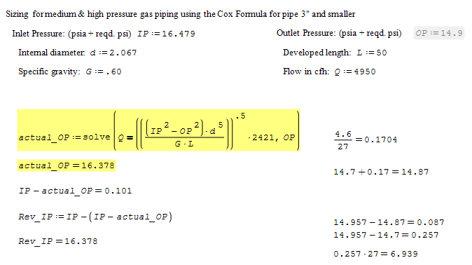

#4 Posted: 9/26/2019 12:49:40 PM
Your problem seems to be quite simple and mentioned here on the Forum many times (maybe to many...).
Using solve()
GASHP-cor.sm (9.94 KiB) downloaded 1083 time(s).

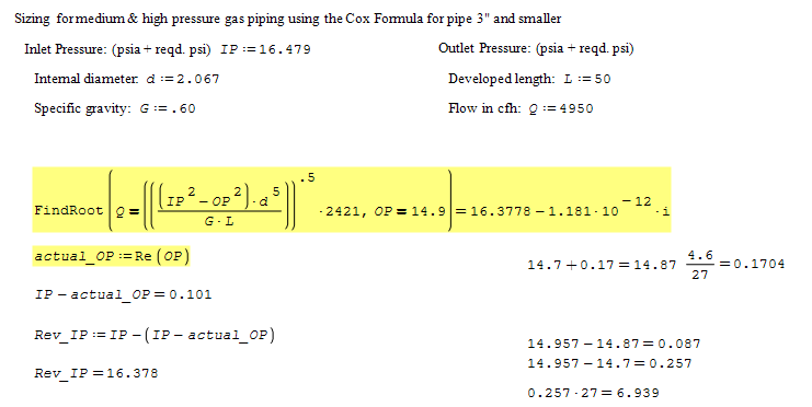

Using FindRoot() from Numerical Solvers plugin
GASHP-cor1.sm (10.16 KiB) downloaded 1098 time(s).
