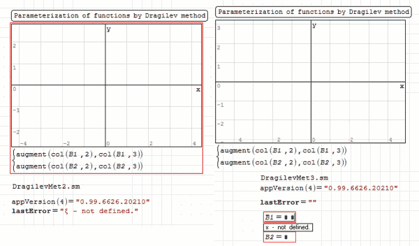

Hola Alvaro, Hello Ber7,
Thanks for your reply, but the DragilevMet2 and 3 files do not work.
The file of Ber 7 does not show any error, but by requiring the value
of B1 and B2, it says that "x" is not defined.
Attached drawing of the errors.
Hello Jean, your files worked perfectly.
Carlos
#13 Posted: 2/23/2018 3:19:44 AM
1,123 likes in 1,795 posts.
Hola Carlos.
It's because a problem with rkfixed routine in your environment. Try to download this, or use it in the cloud: DM_RK

Hola Alvaro:
Gracias por tu respuesta.
Thanks for your answer, but I found the fault.
The interference is caused by the Maxima Plugin,
by disabling it, the file works correctly.
Carlos

Hola Alvaro
Here too, the problem is caused by the decimal separator "Point",
Changing in options, the decimal separator from "Point" to "Comma", (from "." To ",")
resolves the problem of graphing
Carlos
