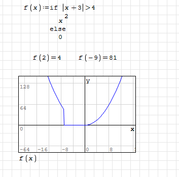

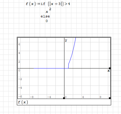

Plot issue?
Plot issue? - Shouldn't this plot from neg inf to -7 and 1 to positive inf? - Messages

#2 Posted: 8/18/2020 4:30:04 AM
Alvaro Diaz Falconi
Alvaro Diaz Falconi
992 likes in 1675 posts.
Hi. Try changing the zoom with the mouse wheel, or it and control or shift.

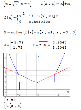

#3 Posted: 8/18/2020 8:32:41 AM
983 likes in 6866 posts.

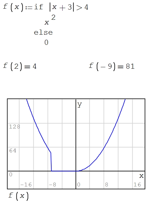

#4 Posted: 8/18/2020 1:16:29 PM
PCPlayer24_7
PCPlayer24_7
0 likes in 2 posts.
Razonar and Jean thanks for the quick replies, I tried Razonar's suggestion and it does fix the issue! I do like the idea to ensure f(2)=4 and f(-9)=81 to ensure the function works correctly.
Jean very helpful as well, I attempted to implement your example and haven't gotten it yet. Not sure if this is MathCad or SMath, I cannot get the "if" statement to work as you have it. So far I get only the "if" "else" from the programming toolbar only. The matrix's work though, so hopefully I get your example working in SMath soon.
