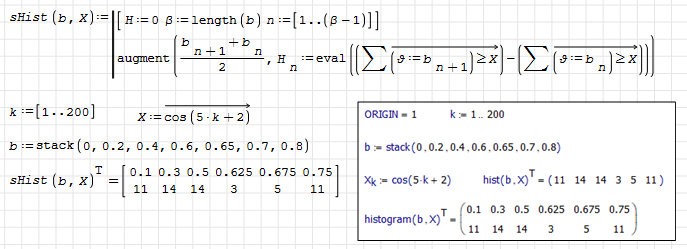

#2 Posted: 10/10/2023 11:36:23 PM
Hi Valery. This function returns the same result as mathcad.
sHist.sm (15.24 KiB) downloaded 1381 time(s).

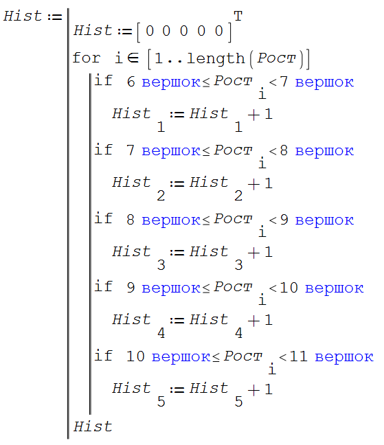

My students histogram

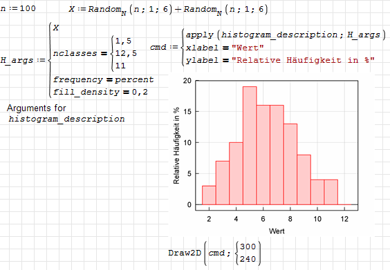

Maxima has a histogram plot function.
Taken from DOI: 10.25933/opus4-2949. The PDF has attached SMath documents.
Valery Ochkov 10/11/2023 8:23:00 PM, Oscar Campo 10/11/2023 9:42:00 AM

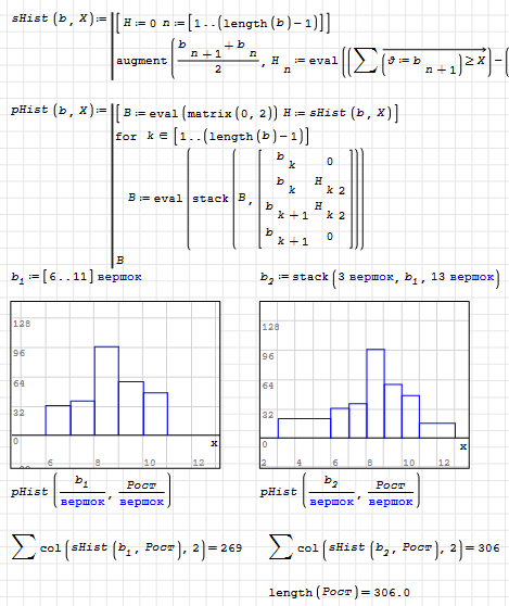

#6 Posted: 10/11/2023 2:43:40 PM
Hi. This version also works with unequally spaced bins.
pHist Mister-Class.sm (61.58 KiB) downloaded 1378 time(s).

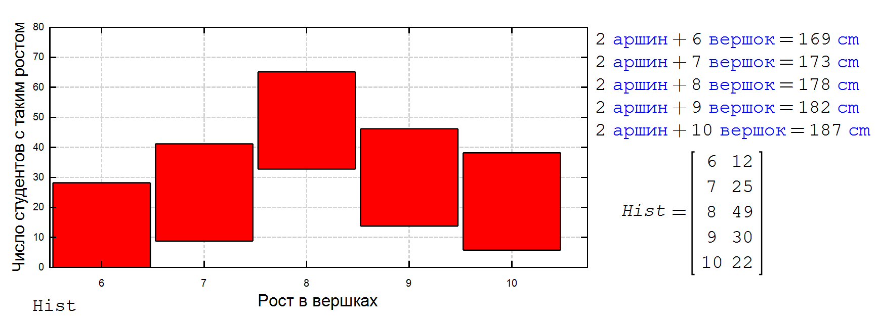

#7 Posted: 10/12/2023 3:08:23 AM
Valery Ochkov
Valery Ochkov
66 likes in 697 posts.
A Live histogram

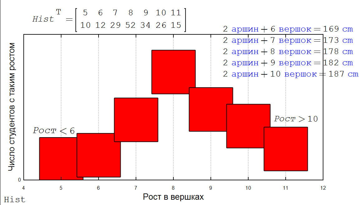

#8 Posted: 10/12/2023 3:53:13 AM
Valery Ochkov
Valery Ochkov
My KISS Histogram

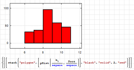

#9 Posted: 10/12/2023 4:48:09 AM
Hi. You can use the above pHist within XYPlot.
Valery Ochkov 10/12/2023 4:49:00 AM, Oscar Campo 10/12/2023 7:32:00 AM
