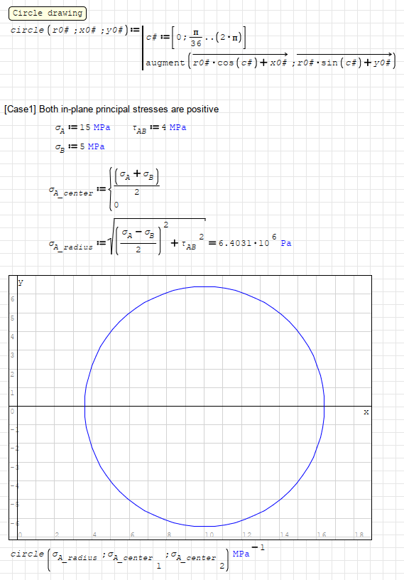

I am trying to plot mohr's circle by following tutorial. I have succeeded to draw circle on the tutorial but not mine.
Could you check my plot?

One way to build a graph is to lower the order of large numbers
Primer.sm (8.51 KiB) downloaded 1067 time(s).
#3 Posted: 3/13/2022 12:32:01 PM
598 likes in 1,379 posts.
You can make a function to draw circles, for multiple usage on same sheet.
With respect to Ber7, dividing it to MPa will lower the numbers too.
MSS.sm (7.3 KiB) downloaded 1114 time(s).

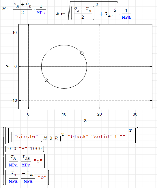

#5 Posted: 3/14/2022 1:06:17 PM
1,355 likes in 2,270 posts.
Here is a version with pre-defined geometric object in the XY plot plugin. See Handbuch section 8.3.4.
MSS_Kr.sm (13.86 KiB) downloaded 1115 time(s).

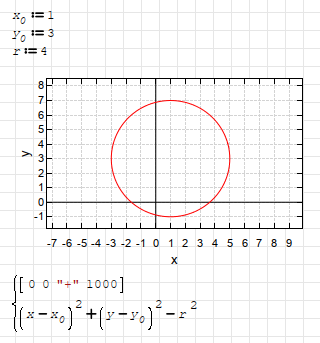

It is much easier to draw circles with X-Y Plot plugin.
circle_xy.sm (5.23 KiB) downloaded 1160 time(s).
