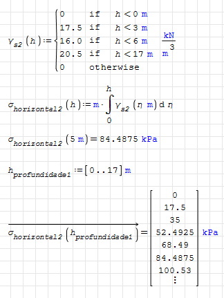

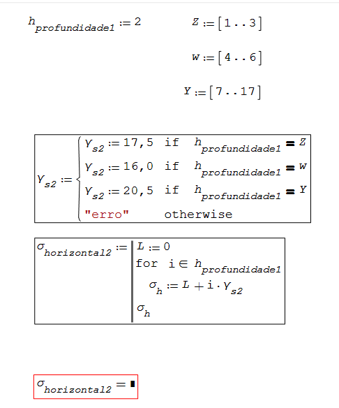

Good afternoon, could someone explain to me how to solve this problem I need that the horizontal voltage varies according to the depth however and the s2 gamma.
my input data is hprofundidade1 z w and y
TESTE TENSAO ADM MATRIZ.sm (5.41 KiB) downloaded 1163 time(s).

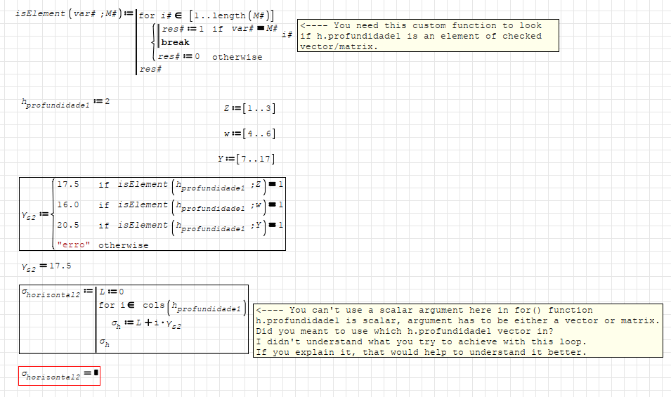

I didn't understand what to calculate in sigma function.
A little more explanation would help to resolve it.

I reworded the file with an SPT matrix, my goal is to loop to find the value of sigma h in the depth that I inform in the input I am attaching a photo of what the final result should look like with the graph

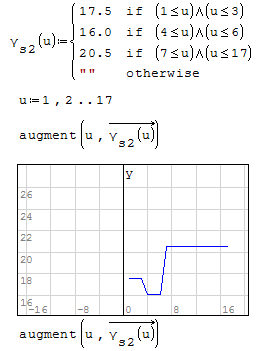

Hi. I think that this could be the solution.
TESTE TENSAO ADM MATRIZ.sm (5.88 KiB) downloaded 1168 time(s).

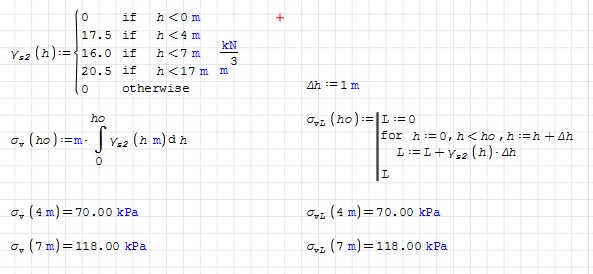

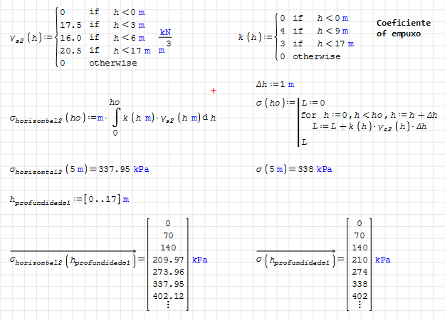

Hi overlord. I guess because using γ.s2(h)*h isn't correct, there the correct acumulation is γ.s2(h)*Δh
TESTE TENSAO ADM MATRIZ.sm (10.8 KiB) downloaded 1138 time(s).

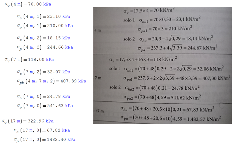

thank you all for making your time available, helping me with this problem but some of the solutions posted here do not match the values must be equal to sigma,v in the image or 70 kN/m2 at 4m depth and 118 kN/m2 at 7m depth.
see the resolution of the problem in the attached image
At this point, up to You to handle the project.
I understood nothing in that big image.
TESTE TENSAO ADM MATRIZ (in_situ parametric).sm (18.6 KiB) downloaded 1213 time(s).
PERFECT FELL LIKE A GLOVE is there a way to rotate the result of the graph 90 degrees?

This is a way to do that in SMath.
TESTE TENSAO ADM MATRIZ v2.sm (455.7 KiB) downloaded 1281 time(s).
