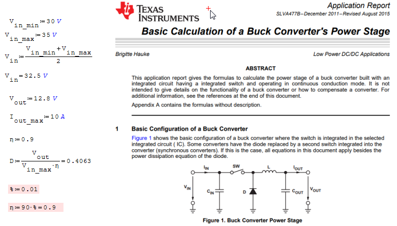

The attached sMath file is an attempt to add "current page" background images. One image per page. It work find for the first two pages, but the third one get skipped and the image appeared on the fourth page.
dc dc buck converter.sm (735.13 KiB) downloaded 1312 time(s).
Basic Calculation of a Buck Converter Power Stage.pdf (202.96 KiB) downloaded 1001 time(s).
The goal here is to study technical document by overlaying sMath formula, graph and other elements on top of the background images.
Also attached, the original PDF file and the png images for each pages.
Also, it is not obvious how to remove background images, either "All" or "Current page". I couldn't remove the ones in the attached sMath file.
Thank you for your help
Guy

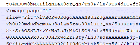

I did not know that several background images can be inserted. Actually, I do not know how to do it either. But as workaround you can edit the sm file for correct the position of the image on page 3.

Thank you for this way around. First time I venture into a sm file. I will give it a try.
As for how to do it, just select "Background..." in the "Insert" menu. You will see the background setting window.

Editing the file worked first try. That is great :-) The sm format is pretty simple, nice to see that.

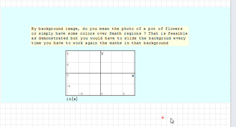

This peanut demo is 2.65 kB. You can have as many regions as you wish,
of any colors out of 1677216 possible colors. The background is OK
by the Print Preview, thus will be saved on virtual *.PDF printer.
This background region is not an imported image, neither an image
created by Smath. Thus, every time you save and at the opening of
the document, Smath complains it can find ... because it is not
really created ... just an incomplete fake. So, on the complain
just click OK to stop Smath suffering.
Jean [Drummondville]

Andrey, this tweak just added a whole new horizon of uses of SMath for me, thank you!!!!!
Fresh example of use to annotate with image region (this is neat!)
