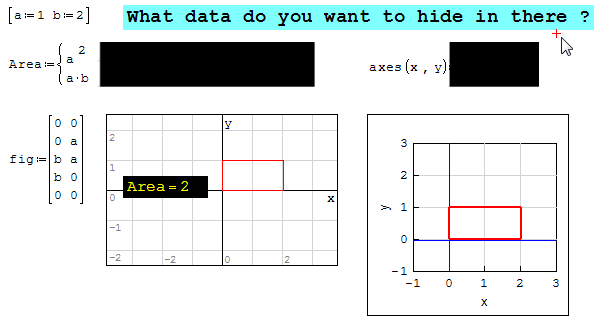

#9 Posted: 7/18/2019 4:27:42 AM
Hi. This is something like you want, but it could be very hard to implement, except for images and some few equations, as in the attached. Playing with include and run utilities, can have more dynamic results.

#10 Posted: 7/18/2019 10:09:42 AM
Razonar
Very interesting. I need to work on this idea. Thank You.
