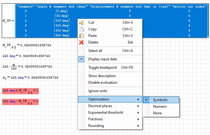

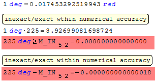

Dear all,
In a cam profile generation program, I perform some boolean operations with angular values (input in degrees).
I noticed some boolean operations fail due to a varying accuracy.
The file in attachment will clarify what I mean.
How can I make these values equal? Reduce the amount of significant numbers?
Thanks in advance for any feedback!
Kind regards,
Jan
Accuracy.sm (7.11 KiB) downloaded 1597 time(s).

Wrote...
...Accuracy.sm (7.11 KiB) downloaded 1597 time(s).
Choose symbolic optimization in the matrix definition.

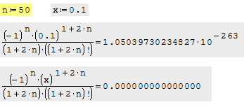

WroteHow can I make these values equal ?
Leave the main matrix numeric, explore Numeric/Symbolic in-situ
The two Boleans disagree ... IMHO, Numeric is the practical procedure.
Cheers ... Jean.
