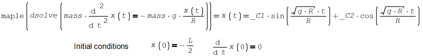

#4 Posted: 7/1/2023 10:51:35 AM
Valery Ochkov
Valery Ochkov
66 likes in 697 posts.
Thanks!
But no way to do so in SMath
"L & m" are missing in dsolve result ?
m is missing in dsolve.

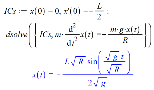

#5 Posted: 7/1/2023 2:48:44 PM
See please one ODE symbolic solution without IC
Hi Valery. Use Ctrl+Shift+K for write D(x)(0), which means x'(0)
Valery Ochkov 7/2/2023 4:05:00 AM

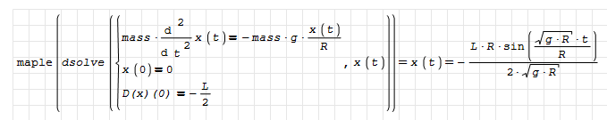

#6 Posted: 7/2/2023 4:06:01 AM
Valery Ochkov
Valery Ochkov
Thanks!
dsolve-ICs.sm (10.61 KiB) downloaded 1440 time(s).

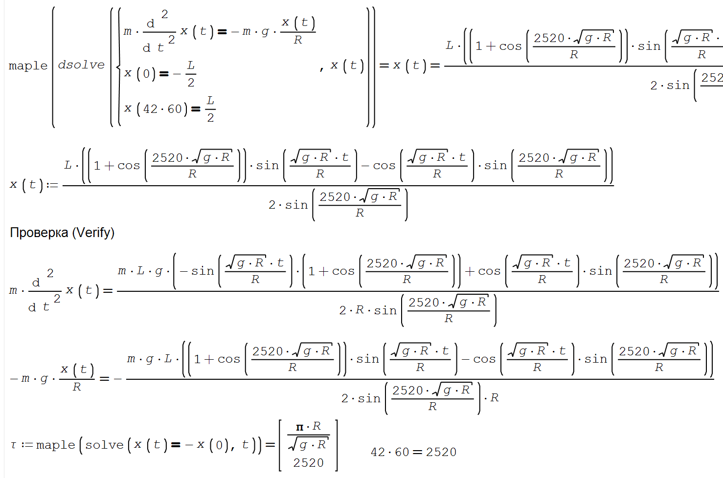

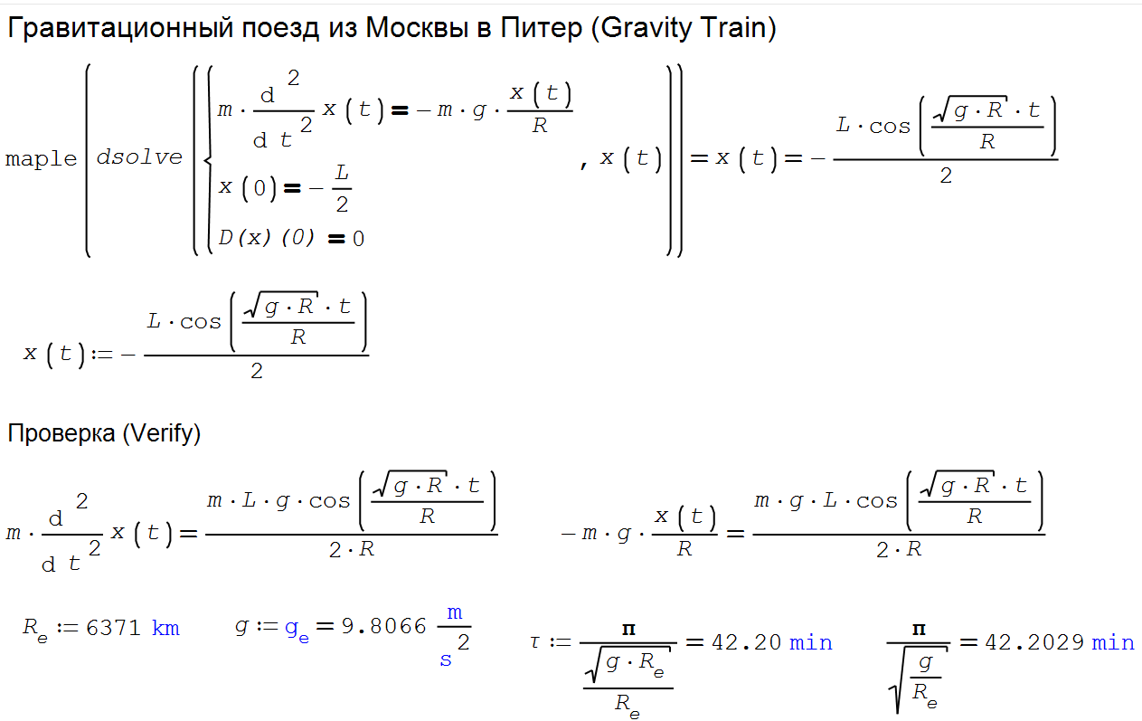

#7 Posted: 7/3/2023 3:43:12 AM
The distance between the cities added.
GravityTrain.sm (31.01 KiB) downloaded 1355 time(s).
GravityTrain.pdf (233.1 KiB) downloaded 854 time(s).

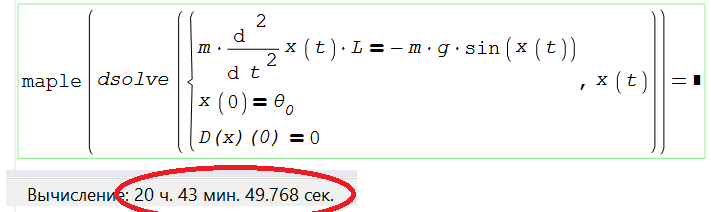

A pendulum
#11 Posted: 7/4/2023 6:53:08 PM
A pendulum ...
The exact solution needs some handwrite work.
Edited: a hard handwrite work. Previous version was wrong.
Click to enlarge
Correct solution -> pendulum v2.sm (13.73 KiB) downloaded 1384 time(s).
Wrong solution -> pendulum.sm (13.88 KiB) downloaded 1388 time(s).
