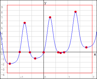

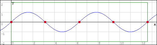

Non iterative methods for root estimation + iterative methods based on the sign(1) function for finding roots and maximum/minimum values in a range.
Signum-based Iterative methods.sm (185.41 KiB) downloaded 1373 time(s).
2016-05-16 17_40_31-SMath Studio Desktop - [Signum-based Iterative methods.sm].png
frapuano 5/16/2016 2:51:00 PM, Andrey Ivashov 5/17/2016 10:36:00 AM

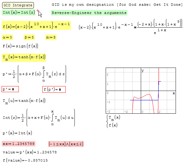

Thanks Davide ... that will make my day !
I discovered the "GID" transit integrator in Mathcad 11.
Works as well in Smath. Don't know if other CAS support ?
Then: like this
#3 Posted: 5/16/2016 9:48:38 AM
BTW: Nobody @ PTC Mathcad Community has seen "GID" integrator,
PTC and Jean ended "warflame" years ago before "GID" [just too bad].
#4 Posted: 5/16/2016 10:12:07 AM
... p'(x) takes a while to plot.
Integrate GID Signum.sm (15.22 KiB) downloaded 1321 time(s).

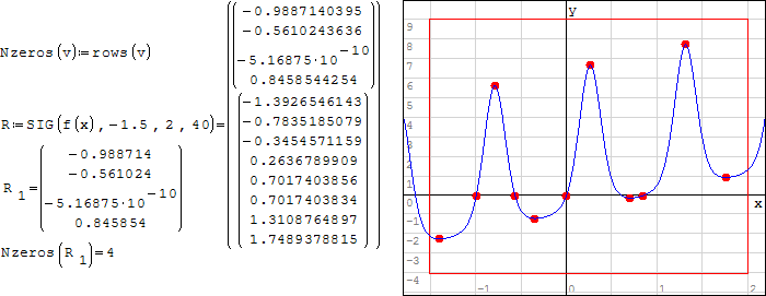

#5 Posted: 5/16/2016 10:48:25 AM
... in your last example: there is a missing 0 and an extra min/max
Davide Carpi 5/16/2016 12:42:00 PM
#6 Posted: 5/16/2016 12:47:09 PM
1,443 likes in 2,935 posts.
True, thank you Jean
Usually it may need to play a little with bounds and intervals. In this case changing intervals from 40 to 41 fixed the issue. (updated the first post)
