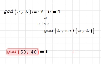

WroteI'm not sure, but I think I might have found a bug:
I remember this used to work before. Am I doing something wrong?

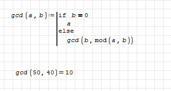

You need to use line operator in function definition.
![2022-11-30 07_40_07-SMath Solver - [Worksheet1_].png](/en-US/files/Download/BAc5be/2022-11-30-07_40_07-SMath-Solver---[Worksheet1_].png)

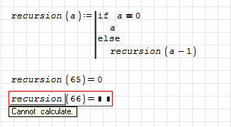

Edit: A note about recursion. I do believe that Andrey limited the recursion depth that can take place. I think its somewhere around 50.

Hi. Every CAS should have a recursion limit. The point would be to be able to control it, like in Mathematica: https://reference.wolfram.com/language/ref/$RecursionLimit.html

Thanks!! How did I forget that. heh.

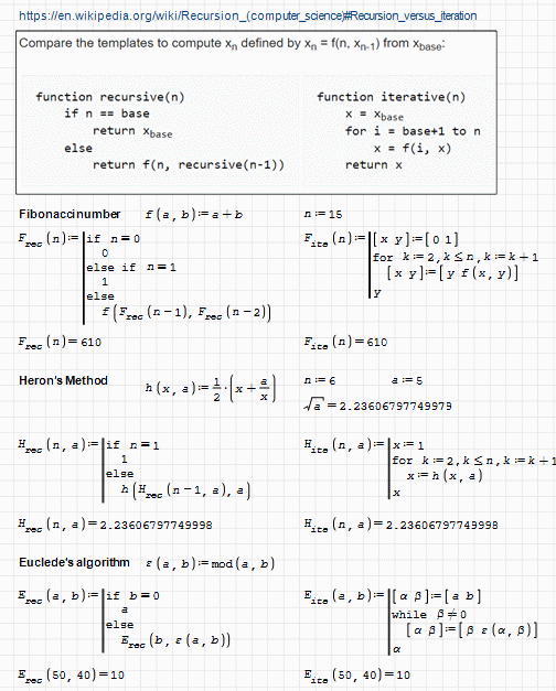

Maths Sqrt(x) Heron DEMO.sm (11.66 KiB) downloaded 1494 time(s).
#9 Posted: 12/1/2022 10:09:52 PM
WroteMaths Sqrt(x) Heron DEMO.sm (11.66 KiB) downloaded 1494 time(s).
Either.
recursive_versus_iterative.sm (40.78 KiB) downloaded 1550 time(s).
