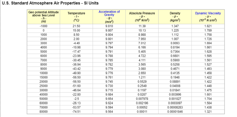

Curiously enough, they arrived at the same conclusion years ago:
Theodore, Jean, [Ralph ?] that altitude is not homogeneous
and represented by rational/expDecay/rational segments.
In this document, we just trust NASA as an act of faith !

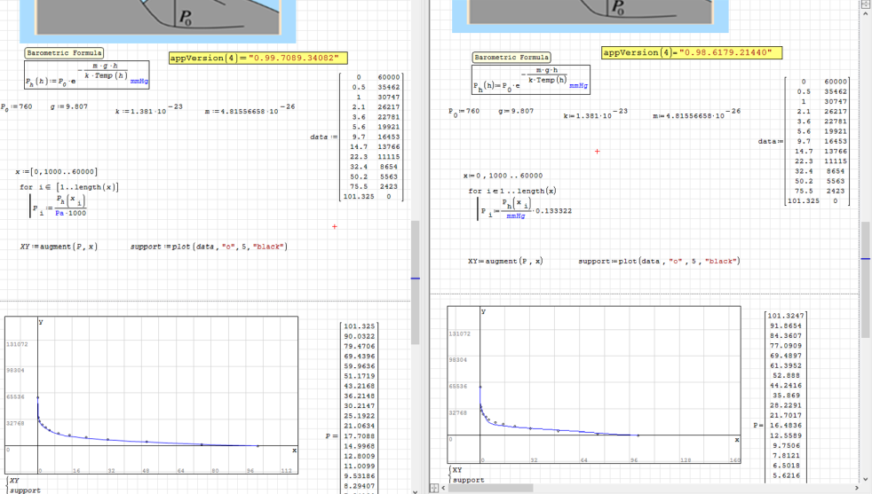

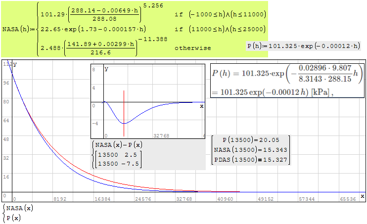

Thanks Carlos,
Unfortunately, SS 6179 can't open the latest SS Beta you are using,
can't read the temperature correction. Math 24 barometric is in fact
so much erroneous vs PDAS, NASA(h) it shouldn't be published as given.
I do not know why SS6179 transforms the units differently to SS7089 and gives slightly different results.
Here you have the file in the SS6179 version.
Barometric_Formula_Air_6179.sm (423.31 KiB) downloaded 1311 time(s).

Thanks Carlos for the SS6179 document.
Polynomic is new to me, more applications expected.
As applied to Barometric, the more abundant data set gives results
very close to NASA. The last step is the [m] altitude vs measured kPa.
Something similar to the other document ... RemToDo.
The P(h) has an inverse RootsOf, of no interest for minimal calculator.
Inst_ISA Barometric Formula [Carlos].sm (455.05 KiB) downloaded 1149 time(s).
WroteI do not know why SS6179 transforms the units differently to SS7089 and gives slightly different results.
Latest beta-versions of SMath Studio have huge improvements regarding accuracy, calculation performance and worksheet rendering performance. This is because currently I'm participating in a project where IAPWS equations is used and it was observed that all previous versions of SMath Studio had problems with accuracy. After reworking core of calculation engines it was observed that calculation speed became worse, so I have started work to improve performance in high accuracy calculations.
As for now SMath Studio became much more usable in both: accuracy and speed points of view (+ new rendering engine is here) and I'm doing latest preparations to release new stable build.
We are now much more close to ver. 1.0

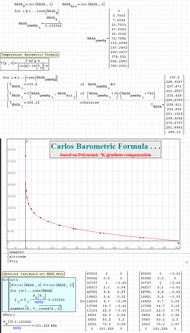

Thank you very much for your excellent work.
I have tried to calculate the temperature used or measured in the NASA data,
isolating the temperature variable from the barometric formula.
I hope you find a better approach
NASA_Invert_SS6179.sm (57.34 KiB) downloaded 1225 time(s).
Thank you
Carlos

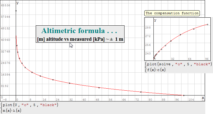

WroteI hope you find a better approach

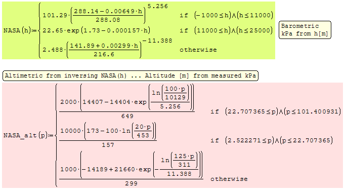

... Here is Carlos . . . an un-ambiguous altimetric formula.
1. NASA solved for well distributed points
2. The inverse Barometric solved for the the compensation parameter.
3. Final altimetric at least up to 40 km
4. Accuracy depends upon NASA itself and kPa resolution
Will read your latest attachment ... Jean

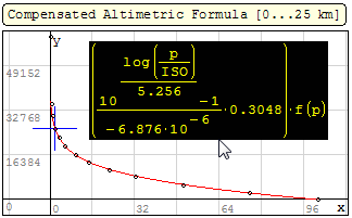

Inst_ISA Altimetric Formula Copy.sm (32.91 KiB) downloaded 1219 time(s).
Formula page 7/7 ... auto-compensated on actual/local ISO [101.325 kPa].
The mutual conformity wrt solved NASA(h) is stricking of realism.
Comments/suggestions ... welcome.
Inst_ISA Altimetric Formula Copy.sm (131.19 KiB) downloaded 1269 time(s).
WroteThe Altimetric session ends here for quite a while unless more revelation.

1. NASA(h) Barometric ... kPa given altitude (h)
4. Nasa(p) Altimetric ... altitude (h) given kPa
................sections [2, 3] not needed for publishing
though guide line for discrete solve.
Just need the dual formulas [image below]
Inst_ISA Barometric_Altimetric Companion.sm (91.43 KiB) downloaded 1258 time(s).
