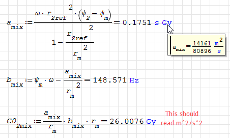

SMath interprets m^2/s^2 as a Gray, Gy
When other variations occur, such as m^2/s, SMath reports s*Gy
I am dealing with annulus fluid flow calcs, and need m/s type units displayed, and not Gy.
I have tried overtyping the units into the respective place holders, but to no avail. What should I do to properly work this out.
I would appreciate any help.
John

hi John,

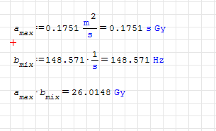

just write the desired units in the rightmost placeholder:

damn!!! I was trying to overwrite the value, and ignoring the right placeholder.
You ROCK!!!
Thanks for the fast reply.
