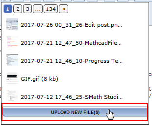

About the attachments, there's a button in the post editor, click it, then choose "upload new file(s)" and finally when you're done "start upload(s)"

#16 Posted: 7/27/2017 8:31:24 AM
983 likes in 6866 posts.
... forgot: to see the attachment bar, you click on "Post Reply"
"Quick Reply" is just text w/o attachment.
