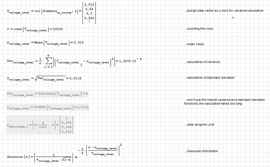

#3 Posted: 4/3/2024 11:32:05 PM
Optimizations were all set to numeric - did not help. What helped was that I substituted the statistic function variance() and StdDev with the original/native formula for the variance and standard deviation.
This speeds it up to around 1s.
Don´t know what happens inside the functions of the statistic plugin but it is very slow.

#4 Posted: 4/11/2024 6:24:17 AM
I have noticed the same thing; the built-in function for standard deviation takes forever but the calculation runs pretty quickly if I just code in the formula in the worksheet.
#5 Posted: 4/12/2024 4:53:41 PM
Confirmed, the bottleneck seems to be in the final ouput processing to return the result from the equation [f.e. 1/{n-1}*sum(((el(X,i)-mean)^2),i,1,n)) for StdDev]; no idea not sure what could be the cause...
