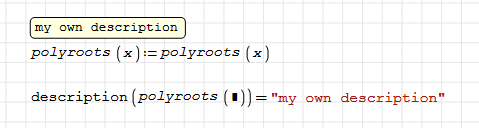

You can add your own description(s) in this way.
besides , is it possible to support orther languages?
If you mean in the description, just right click on the region that holds the definition and change the language on the context menu; you can add a description for each language.
If you want another language to be supported, you have to ask Andrey directly.
