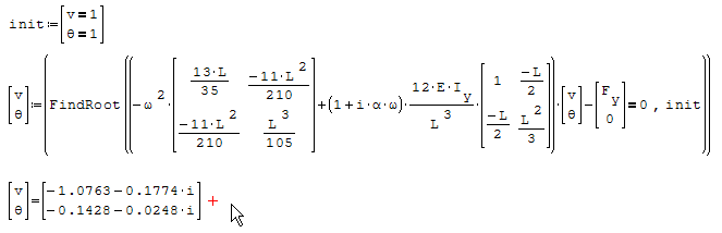

#4 Posted: 6/13/2023 9:29:58 AM
I think the problem is that the units don't match.
Compare the units of the components of the two terms inside the brackets
that multiply the [v; theta] vector.
FindRoots ignores Units. Code the image first.
Solve FindRoots Complex Forum.sm (11.09 KiB) downloaded 1410 time(s).

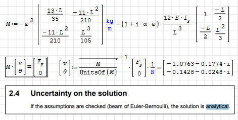

#8 Posted: 6/13/2023 4:34:30 PM
Besides correction of the unit mismatch, Solve seems to want the matrix equation in homogeneous form.
Matrix equation_Kr.sm (14.1 KiB) downloaded 1344 time(s).

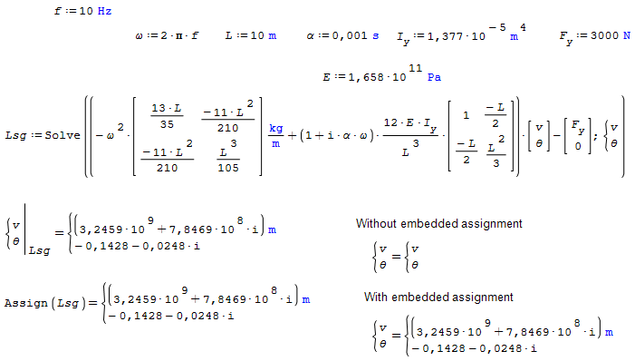

#9 Posted: 6/13/2023 6:25:48 PM
Hi. Another way.
