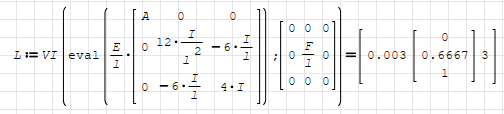

Yes, it is correct. Yet I consider the need to place eval() being a workaround for a bug. A similar workaround is to introduce an intermediate variable.
It seems that the error is related with broken logics of matrix operations. If I remove the factor in front of the matrix, then the function call works. Seems that at some point the evaluation logic thinks that the expression is not a matrix and complains in a not very helpful way.
Actually I found the culprit, it's the Ones() function. Davide, if you could ask that function to evaluate it's argument before refusing it, that would be fine.
![2023-02-27 19_39_15-SMath Solver - [Vektoriteration AEWP.sm_].png](/en-US/files/Download/q5wLqv/2023-02-27-19_39_15-SMath-Solver---[Vektoriteration-AEWP.sm_].png)

#6 Posted: 2/27/2023 4:19:04 PM
Wrote1) Yet I consider the need to place eval() being a workaround for a bug.
2) Actually I found the culprit, it's the Ones() function.
1) I agree, putting line() or eval() sometimes is cumbersome. And unnecessary.
If necessity of them would be removed in all possibilities, it would be awesome.
2) You are 100% correct. I wonder how many of these little bugs out there.
This little change of code worked just fine.
