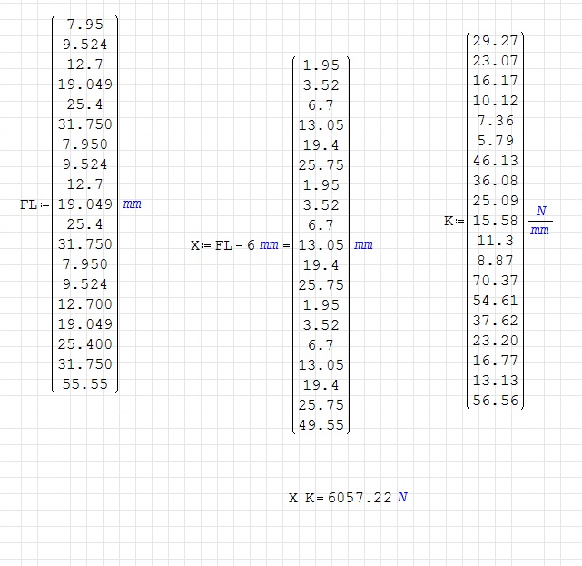

I am trying to multiply a column with 18 values by another column with 18 values and get 18 results, but instead i get 1 ?

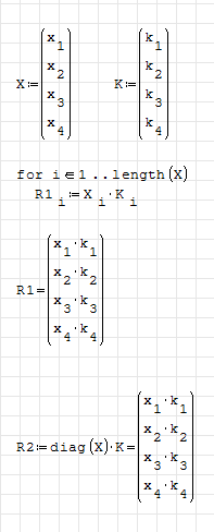

to make an element by element multiplication use a loop or use the diag() function on the first vector

Thanks !!!!
