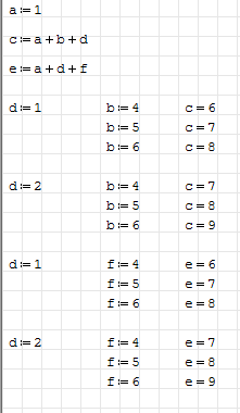

#3 Posted: 10/31/2013 7:53:29 PM
#4 Posted: 11/1/2013 8:24:25 AM

![2013-11-01 00_50_21-SMath Studio Desktop - [undefine%20variable-1.sm_].png](/en-US/files/Download/RBMHKs/2013-11-01-00_50_21-SMath-Studio-Desktop---[undefine%20variable-1.sm_].png)
