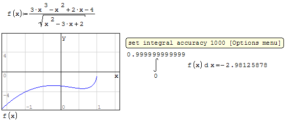

I have the following problem, trying to solve the definite integral int((3*x^3-x^2+2*x-4)/sqrt(x^2-3*x+2),dx,0,1): I get the error "x - not defined" and, of course, no result.
If I change the limits to [0..401], I get a result (!) with no error message, but if I set the upper limit lower than 401, I get the error again...
What is the reason for that?
Thanks in advance for your replies.
Conrad
The integrand is undefined @ x = 1
#3 Posted: 2/7/2019 11:41:17 AM
983 likes in 6866 posts.
Three verdicts in there:
1. Nothing will integrate that freak above x=1.9999999999999999999999999999
2. Nothing will integrate up to x=0.99999999999999999999999999999999
3. Can only integrate in reasonable range of the integrand.
Interesting Classroom example ... always plot the integrand !!!
IntegrateFreak.sm (7 KiB) downloaded 80 time(s).

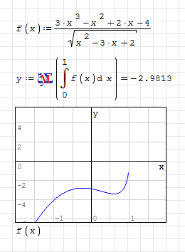

you can use maxima plugin if it is necessary.

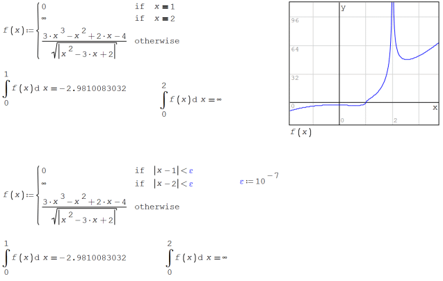

Hi. I think that here the point is how to handle avoidable discontinuities in SMath. Because integral and other operators or functions not accept the 'if' statement, you can use 'cases' in the definition of f, as this:
Even this isn't the case, this other is more general for avoiding numerical issues with avoidable discontinuities:
sergio 2/8/2019 8:59:00 AM

About the other discontinuity, at x=2, I guess that you don't want to work with complexes. It's usual take the absolute vale of logs and roots in real analysis calculus. This other isn't avoidable discont, but can be handled in a similar way.
discont_integral.sm (8 KiB) downloaded 85 time(s).

maple() also can do that.
frapuano 2/8/2019 9:53:00 AM, NDTM Amarasekera 2/8/2019 12:14:00 PM

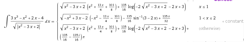

... This other isn't avoidable discont, but can be handled in a similar way.
Well, actually, the integral converges for x=2, as one can see in this wolfram result
That's means that numerical procedure for computing int in SMath needs some improvements.
