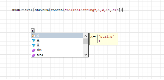

I had another idea using line function. But i'm not sure how to do it programatically... Any Ideas? Is it even possible?
Worksheet8_alternateIdea.sm (22.9 KiB) downloaded 839 time(s).

Aha! I figured it out
I'm pretty happy with this solution.
Here's my updated file for a reference:
⚜ Kenny Lemens, P.E. ᵂᴵ 10/26/2022 11:32:00 AM, Alvaro 10/26/2022 2:29:00 PM
