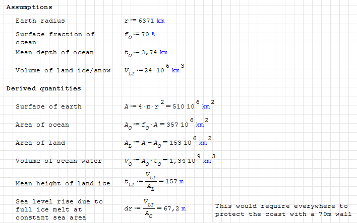

I vote not for a wall nor containment dam (even before you need to ask it to a Nederland engineer), but for dredging the sea floor. Can you estimate the energy for do that: Dredge 24E6 km3 of sand (or whatever there is at the sea bottom) and transport it somewhere not to far? Just assume no problem about where to locate it.

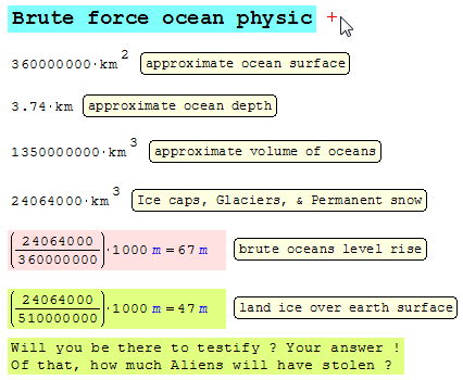

I like your idea of digging the sea bed, long term project for Nederland Engineer(ssssss...)
Will they dig as fast as the sun will melt land ice ?
Did some Savant measured the difference in sea level between winter/summer ?
Plenty of land ice in winter, much less in summer.
Southern hemisphere certainly does not balance northern hemisphere winter/summer.
As long as I can sleep tonight !
