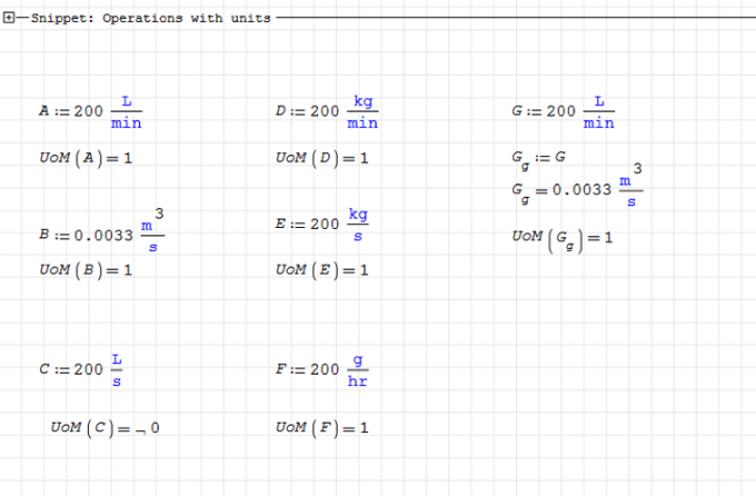

Hello
The unit operation snippet fails to detect units.

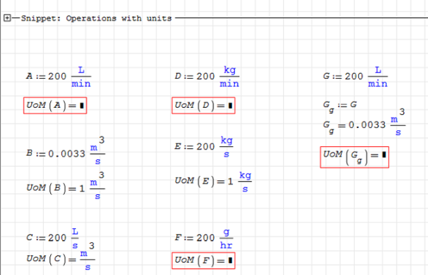

WroteHello David
Thank you very much for your answer, but the snippet fails, since instead
of finding the units, it only obtains the value of 1
My bad, IDK why but yesterday seemed to work to me, but in fact it doesn't. I'll give another look at the snippet ASAP.

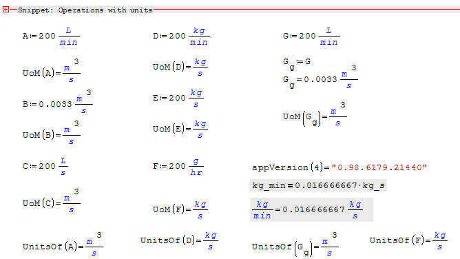

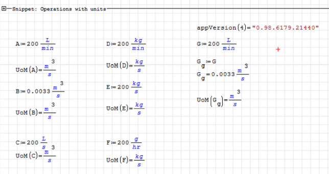

#6 Posted: 5/18/2022 2:00:44 PM
I see the issue. The function look for a numerator/denominator pattern in the num2str() text, but doesn't handle cases in which multiple divisions are involved.
#7 Posted: 5/18/2022 10:47:59 PM
#8 Posted: 5/19/2022 8:28:50 AM
