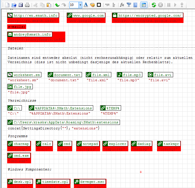

Davide, I experience strange problems with hyperlinks with SMath 0.98.6179 and a fresh hyperlink region plugin.
The links in your docs (from post #1) work fine.
If I copy them to my handbook page, I get "System can't find the file" messages for the links marked with red background, both documents in the same instance of SMath. No matter if portable or installed distribution...

#43 Posted: 1/2/2017 12:35:03 PM
Try now, it should be fixed.
Also:
- SMath Viever now should be able to open relative links (if the file exists);
- SMath files they can be opened even from SMath portable (a new instance of the current SS will be used to open the files, as in Writer Region);
Martin Kraska 1/2/2017 1:11:00 PM
#44 Posted: 1/2/2017 1:10:41 PM
Confired, thank you.

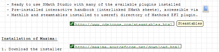

I am using it with version 0.98.6179 but generation
of executable version (viewer)
SMath Viewer Options
1. When check "Full version" in set - doesn't work for me.
HyperLink is not active
2. When uncheck "Full version" in set - all right.
HyperLink is active
explanation in the picture
http://pixs.ru/showimage/Question1p_4537918_25177731.png
