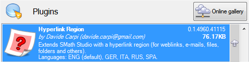

First Beta available through plugin's Gallery.
Documentation and translation sheet in the first post.
Best regards,
Davide

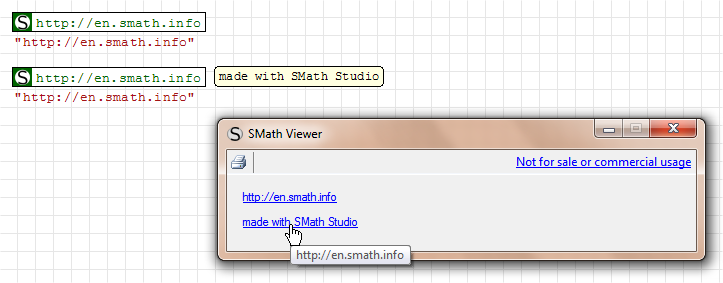

UPDATED
- Support for SMath Viewer
best regards,
Davide

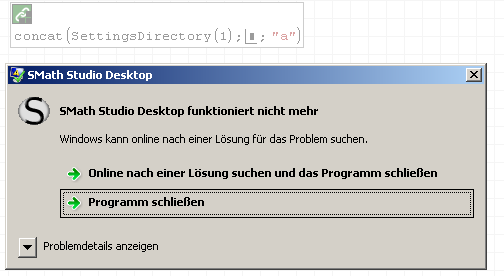

SMath crashes when I try to edit the input expression of a hyperlink.
I write concat with three arguments, fill in the first and the last. As soon as I want to type to the second placeholder, the crash occures.
#16 Posted: 8/9/2013 7:07:15 PM
1,443 likes in 2,935 posts.
Fixed, please test the update
