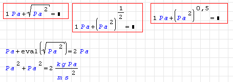

SMath refuses to correctly handle the given example: error "Units don't match"

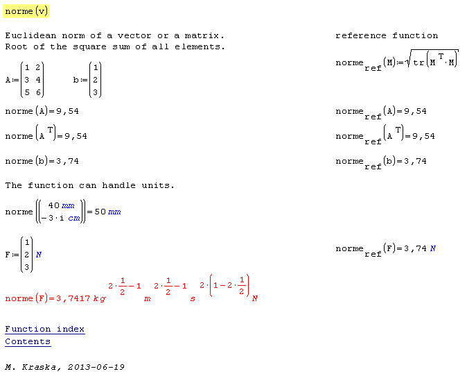

Maybe, this problem is related. SMath fails to correctly simplify exponents of units.

I noticed that the operator Eval is only required for the square root

It seems to work without eval if one raises the expression to 0.5 instead of using the square root symbol.
Can't confirm that.
Can't confirm that.
It's strange, it happened to me the same as you but then changed the decimal delimiter and saved the file, closed it and opened it again, this time the calculation was right. it could be an issue related with saving the current session settings.

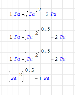

Can you confirm this ? the first one is opened with period decimal enabled on tools->options, the other one with comma.
#12 Posted: 8/7/2013 2:11:55 PM
Kilele, I confirm a dependence on the decimal separator setting, however, quite different from what you show.

Yes we are experiencing different results!
For your information I'm using the unofficial portable version 0.96.4909 which I think it is the 32bit patched one, my os is Vista32. I wonder if this is related to the way variables are dealt with on 32-bit and 64-bit systems.
I think that not only the decimal symbol has influence but also the different combinations with the argument separator, some of them make the eval expression fail or even 0.5 is reported as "input string does not correct format", apart from the already mentioned error "units don't match".
