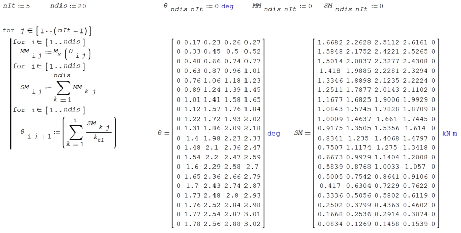

In this sample, when I iterate to find θ, I have no problem at the first time.
test.sm (28.77 KiB) downloaded 1121 time(s).
Then, when I want to calculate SM matrix, something goes wrong:
- Do you know what is the problem?
- The expression to find θ and SM is the same. Could I use only one expression to calculate these 2 variables?
Then, if y change Cm coefficients in order to find a new θ value, the expression don't work,
- I'm lost
Some feedback?? Thanks in advance!

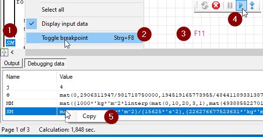

Start Debugger
1. mark code line
2. set breakpoint
3. start debugger F11
4. continue to breakpoint
5. copy to empty page (better to a 2. instance runing) to examine what you have

The error happens because inside the SM procedure (it's a procedure when line is used on the RHS of a variable) you are trying to assign a matrix element to an existing scalar (Θ, defined in the procedure right above). To avoid it, you should initialize the nested variables before using them, f.e. using or
If the existing variable θ was already a matrix, you would have ended overwriting the original values without warnings. This is a powerful feature of the program but if you are not aware of it you might end with some crazy results.
In general when you are inside a function or a procedure it's a good practice to always initialize the variables that are meant to be "local"; if you want to inherit a variable and change his value(s) only locally you have to assign it to a local variable. Obviously it can be avoided, if you are aware of the behaviors and you are sure there won't be any accidental inheritance/interference in the worksheet, like for small examples and such.
Θ:matrix(rows, columns)
Clear(θ,...)
