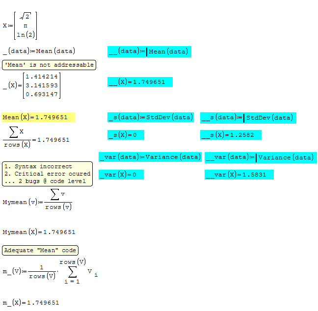

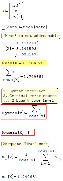

#1 Posted: 12/8/2016 11:33:38 AM
If not corrected since 5346 [official release].
Bug Mean.sm (6.21 KiB) downloaded 1243 time(s).

#2 Posted: 12/8/2016 2:11:37 PM
It seems not quite yet
StdDev(), Variance() will give zero values. Quite strange .

#3 Posted: 12/8/2016 7:38:14 PM
Thank you guys, I'll fix these functions ASAP
As shown in Radovan's screenshot, the second bug is fixed in current version of SS.
#4 Posted: 12/9/2016 3:22:27 AM
You are welcome Davide, and thank you
By the way, It seems there are some more functions affected by this bug (like Median(), Mode() etc.). I do not know how many of them might be.

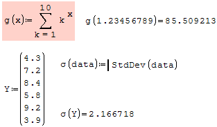

P.S. It crossed my mind this bug as well - summation problem. Are these bugs connected in any way? In both situations you have to use line() environment and the calculation is Ok then.
#5 Posted: 12/9/2016 10:55:23 AM
Quite right Radovan,
The stat package understands local line definition.
5346 does not suffer the iterator problem you attached.
