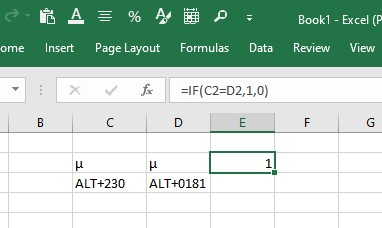

Hi. You're right, SMath can't recognize the difference. But MS Excel neither, or at least I cannot define in excel one that is different from the one called 'micro' in the windows' character map.
Mu-Micro.xlsx (8.22 KiB) downloaded 1286 time(s).
