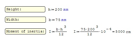

#7 Posted: 3/22/2014 9:22:32 AM
The cm unit seems to be placed as separate region (text or math) right to the result. In order to get this right, you might place another region showing 4 to fake the exponent. Or just use a math region.WroteAn added problem is the units.
I would not vote in favour of writing the same input twice. If you want to change an input value, you would need to scan the complete worksheet for occurences of the values. What if a stupid user assumes that he is done with assigning the values to the corresponding variables? That sounds dangerous to me.
In the given example, the parens around the values help a lot with readibility. Thus, perhaps it would be a good idea to generally put non-optimized substitutions within added parentheses as default SMath behaviour. Then the spurious parens could be removed.
Nebenrechnung.sm (7.46 KiB) downloaded 1326 time(s).

WroteThe cm unit seems to be placed as separate region (text or math) right to the result.
That's a mistake of me, it should be cm^4 and yes, it is wroten in a text region.
WroteI would not vote in favour of writing the same input twice. If you want to change an input value, you would need to scan the complete worksheet for occurences of the values.
That's of course another problem. Your solution without parens seems to be a better alternativ. Other question is if the purpose of the document is to show the equations to the students or let the students work with it too.
