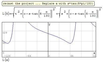

#2 Posted: 10/13/2019 6:23:01 PM
Oh ! ... your proposal is not much productive, is it ?
The picture is strictly discontinuous.
Reflection.sm (54.37 KiB) downloaded 1093 time(s).

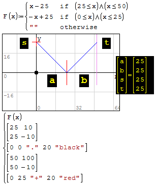

#5 Posted: 10/13/2019 11:00:11 PM
What am I missing here ?
You are missing to plot the literal demo diagram,
here is as per your inputs [a,b,s,t].
More is missing from incomplete project description.
Reflection [abst].sm (62.14 KiB) downloaded 840 time(s).
#6 Posted: 10/14/2019 11:27:00 AM
Refreshed from your literal inputs.
You may have to revisit your College Physics book.
Cheers ... Don't hesitate.
Reflection [abst].sm (128.95 KiB) downloaded 839 time(s).

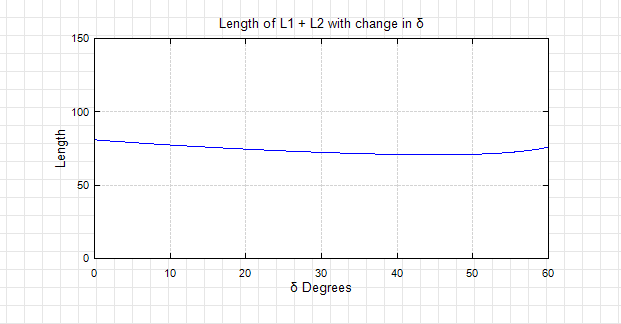

#7 Posted: 10/14/2019 11:46:04 AM
Arie
Arie
94 likes in 285 posts.
I don't think L is discontinuous for ddegrees in the range 0 to 60.
L(ddegrees) should vary smoothly from L(0) to L(60)
Yes the length L is continuous with respect to ddegrees. I think Jean misunderstands the question. See attached. (A little sloppy but it works)
Edit: Updated graph to add labels
Edit2: Had an error in definition of L. Fixed.
Reflection_alyles.sm (177.77 KiB) downloaded 1105 time(s).
#8 Posted: 10/14/2019 1:45:09 PM
Quite right: misunderstood the travelling distance vs °incidence.
Thanks, interesting project. We need more real projects.
Reflection [abst, alyles].sm (186.64 KiB) downloaded 883 time(s).
#9 Posted: 10/14/2019 3:31:04 PM
... You can have it to a good degree of accuracy
as a continuous function, though a bit strange.
Reflection [abst, alyles].sm (252.97 KiB) downloaded 867 time(s).
#10 Posted: 10/14/2019 4:00:54 PM
Arie
Arie
FYI Jean you're using one of my earlier files where I had a copy paste error in the derivation of L(d), the second root term should only have s*tan(d*pi/180). You can get rid of the "c-"
#11 Posted: 10/14/2019 5:47:14 PM
Thanks ... updated.
The model fit is brute force, limited.
From my 100's models, not one immediate.
If interested: let me know, not sure if possible.
Reflection [abst, alyles].sm (209.76 KiB) downloaded 886 time(s).
