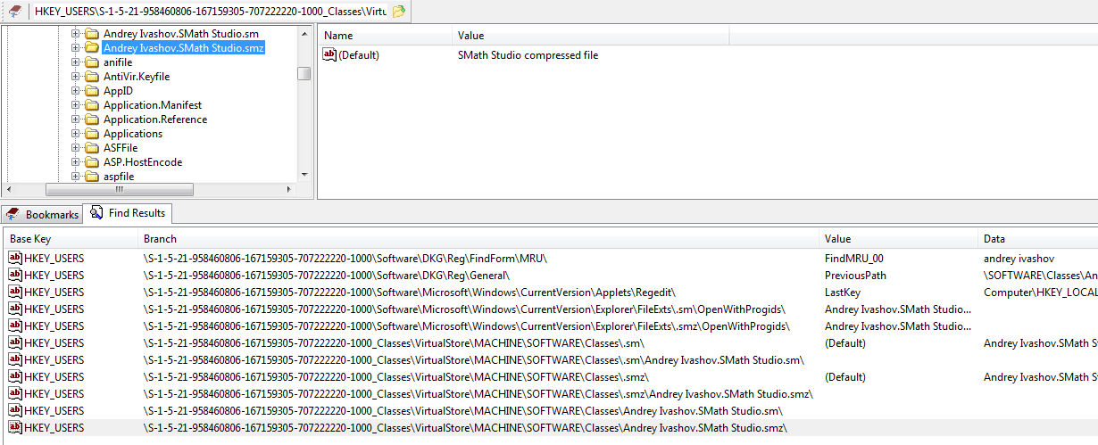

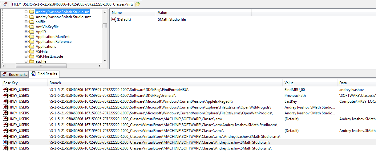

These are registry keys about file type description for the current user
Quote
HKCU - Abbreviated from the registry key name HKEY_CURRENT_USER. HKCU stores settings that are specific to the currently logged-in user. The HKCU key is a link to the subkey of HKEY_USERS that corresponds to the user; the same information is reflected in both locations.
Quote
HKU - Abbreviated from the registry key name HKEY_USERS. HKU contains subkeys corresponding to the HKEY_CURRENT_USER keys for each user registered on the machine
