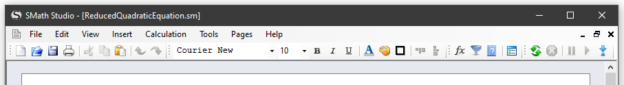

Problem for me is I can't change font, bold, italic or underline options.
Toolbar is there but not working. Windows 10 Pro x64 v1903 if it helps.
And a suggestion, the font selection should be with searchable combobox.
*sorry, I had tried to change font outside of the text region. This is not possible for now I guess.
I figured out you had to be inside the text region and select the text to alterate the font, obviously.
(Font doesn't support style regular)
For usability I'd recommend to expose just a small subset of the fonts in the selector (say arial, roman and courier) and leave further options to the context menu or some expert mode.
Also, I recommend to set arial as default font of text widgets (as in Writer plugin).
I guess we will see the option to apply attributes to selected text instead of the whole region soon.

WroteProblem for me is I can't change font, bold, italic or underline options.
Please describe when it doesn't work? 1) Create a text region 2) Ensure Region is focused 3) Try to change font settings. Is it working?
WroteAnd a suggestion, the font selection should be with searchable combobox.
It is currently searchable actually. Just press first char of the font name you want while dropdown is opened.
WroteI get a (recoverable) soft crash when browsing fonts with the font selector widget. The preview of some fonts is empty in the dropdown list.
Thank you. Will fix it.
WroteAlso, I recommend to set arial as default font of text widgets (as in Writer plugin).
Yes, will do this. Previously (before TextRegion reviewed) it was not possible.
WroteI guess we will see the option to apply attributes to selected text instead of the whole region soon.
Writer Region is best one for this kind of needs.
I had figured text has to be focused, not region. Edited the previous message near 1 hour ago, sorry.
I have mentioned the searchable combobox as in office word, msword, etc. Not only for the first character of the fonts.
Yes, as for now I agree. But I bet every new user will be frustrated when finding out that text formatting can't be applied just to the selection.
Another (hopefully temporary) workaround is to embed a text region into another text region and to format it separately. However, there are alignment glitches and you can't copy and past such embedded texts:

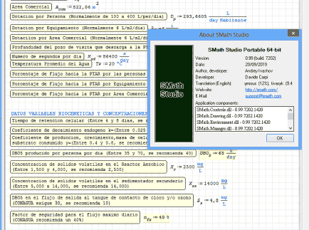

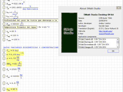

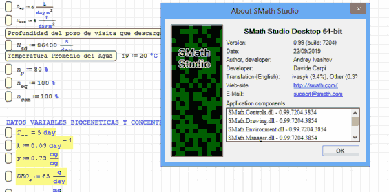

WroteOh !, the version of Smath Studio 7204 has the same problem
in displaying the description of variables as the version of SS 7200.
Looks like you have saved broken document in 7200. The issue there was that it was not able to load translations for descriptions, so after save it saved everything except those descriptions. Now there are no descriptions, because these entries lost.

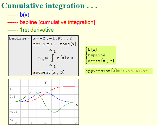

WroteYes, as for now I agree. But I bet every new user will be frustrated when finding out that text formatting can't be applied just to the selection.
That image looks same SS 6179 fails to open SS 7109.
Just observed similar incompatibility ... ?
have strictly no interest in the math suite of project(s).
For publishing, SS 6179 is very similar/superior to
OriginLab 7.5... superior to Mathcad 11.
No shame to publish the attached ... organize at will.
Images in Forum aren't 1/1 in file any more [several months].
Just suggestive for interested users.

WroteWroteOh !, the version of Smath Studio 7204 has the same problem
Here is the same file running on a portable version of SS-7202,
which shows that the description of variables appears complete.
The same file running in the SS-7204 version, which shows that the description of variables does not appear complete.
Carlos
WroteThe same file running in the SS-7204 version, which shows that the description of variables does not appear complete.
