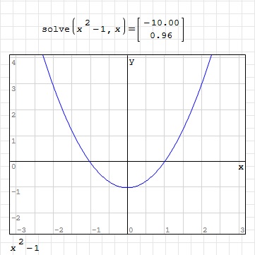

Hello, please tell me what is wrong with this function?
Solve problem.sm (2.86 KiB) downloaded 806 time(s).

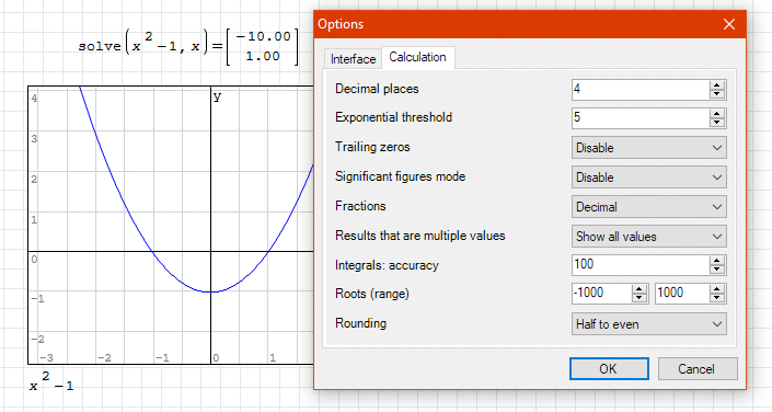

The solution method is numeric and depends on the search limits of the roots. By appropriately setting the limits to the nearest values (Tools->Options->Calculation->Roots (range)-10 + 10), you get the correct result. Downstream of a numerical solution, it is always necessary to proceed to the direct verification of the result (sanity check).

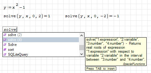

How to handle with it if it is defined globally for spreadsheet and not for exact calculation?
Use solve(4) instead of solve(2). The one with 2 arguments it's handly for calculations on the fly, but not reliable for structured calculations.

If you put some big range, you get wrong answers, like in this picture
