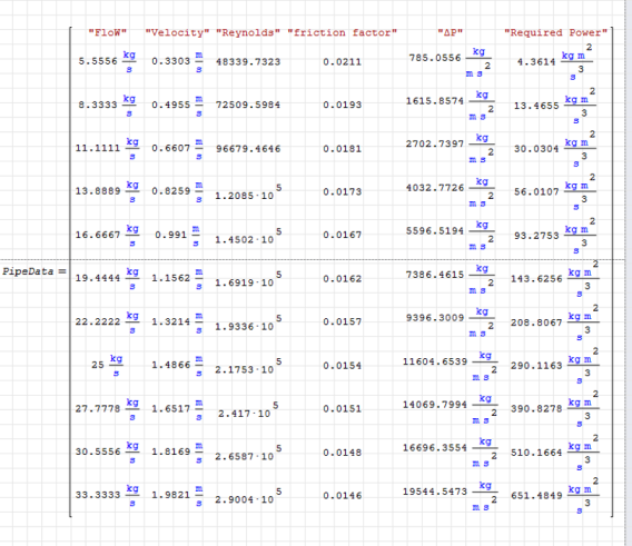

Hello
Does anyone know how to change the following units in the matrix shown below?:
from "kg/s" to "t/hr",
from " kg/{'m*'s^2}" to meters Water Column ("mH2O"),
"{'kg*'m^2}/{'s^3}" to Watts.("W")
Colebrook_SI_CBG.sm (29.41 KiB) downloaded 1221 time(s).

Hola Carlos. You can use matrix algebra in the unit placeholder. Here one solution.
Colebrook_SI_CBG.sm (24.74 KiB) downloaded 1246 time(s).

#7 Posted: 4/24/2022 5:39:01 PM
Hello
Many thanks to Overlord for his suggestions and solution.
Muchas Gracias tambien a Alvaro por su solucion.
I also thank Jean.
Carlos

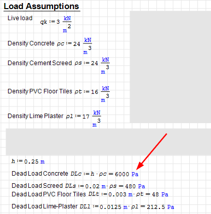

That moment you realize you didn't save a copy of the problem :/ just redid it and realized I have a lot to learn about this program
Thanks for the welcome
Coversion Problem.sm (26.14 KiB) downloaded 1238 time(s).

WroteHow do I set my units so my answers are in the unit I want?
Your attached document is fine. Jean's computer is broken.
About your question, there is a placeholder within results.
It will appear when you select result. It appears as a black square.
You can change your desired result units by altering it.
Here is a demonstration how you can do that.
